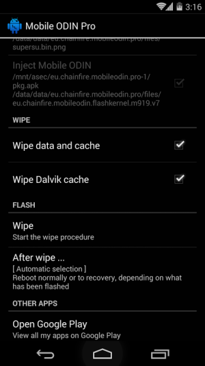

Now scroll down to the "Wipe..." section and select both data/cache and dalvik cache.
