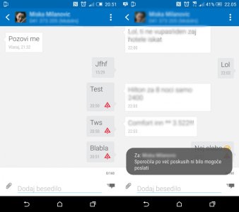

Hey
Me and my gf both bought new M9's through our local carrier and are experiencing exactly same problems.
The problem is that everytime 4G is turned ON, sooner or later SMS and internet will stop working and every time I need to do a reset or do the ON/OFF on the airplane mode - after that everything works again on the 4G immediately. To me it looks like this is some bug with 4g transitioning to 3g/2g and for some reason it "stucks" there and can't do the transition. As soon as 4G is disabled, everything works normally.
This happens on daily basis, on multiple locations and is becoming very annoying as obviously we want to use the 4G network as well. Our carrier told us to send it to local warranty repair centre but I'm not sure how they could do anything since it's affecting every phone as it seems and this sounds like an HTC bug.
Is someone else experiencing this as well?

I am on Simobil Slovenia. As for disabling 4g, what I meant was I switch to only 2g/3g in network settings.
