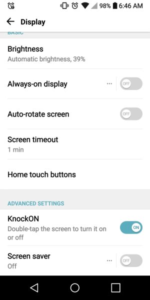

Sorry if this seems like a silly question, but just to be sure -- you're looking at the display timeout setting (i.e., how long the screen will stay on while idle before turning off), and not the Automatically Lock setting (i.e., how long after the screen has turned off before the phone actually locks, requiring you to go through the lock screen again), right?
nicjimbass
Active member
Apr 25, 2017
43
Visit site
It's this one, located under Display. It was giving me a hard time yesterday, but seems to be staying at one minute since last night.
