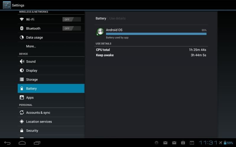

    I rooted my Xoom and running Eos 1.0.0 ROM
    I noticed that my battery life started sucking and went to see what was eating it and discovered that the Android OS itself was the culprit.
    55%
    CPU Total 1h 25m
    Keep Awake 3h 44m
    What is causing this?? Any thoughts or suggestions to rectify this??
    From my Thunderbolt for comparison -
    2%
    CPU Total 5m 55s

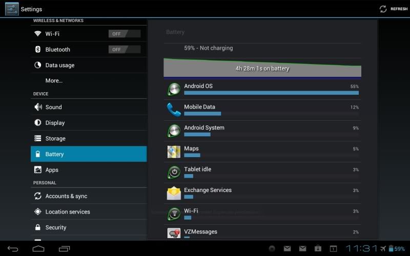

    No one???
    Here is a look at just what is eating it...
