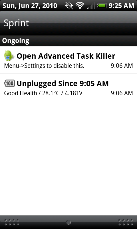

Hi I just bought a cheap $4.00 universal battery charger from Ebay and started charging it last light and popped it in my Evo this morning and the battery stayed at a full 100 for a half hour with with barely any usage, which is how it should be if you don't use your phone. When charging the battery in the Evo, It would go from 100 to 90 in 10 minutes with no usage. When charging it with the battery charger it stayed at a 100 for 20mins with no trickle down effect. I'm going to do some more test, but so far I think its a flaw in the Evo hardware circuits for it to lose battery power so fast with minimal usage. I'll post back with more results

yupp, I get the same results with my Seidio charger. my phone will go anywhere from 1hr to 1.5hrs before dropping below 100%

I am neither a chemist or an expert on batteries, but I do have a science background. Regardless, I remember some talk about this subject previously. My understanding, and please correct me if I am wrong, is that the OEM charger will charge overnight to 100% and then stop. So let's say you plug your phone in at 11pm and it finishes charging at 3am. Then the phone will just use power from 3am until you unplug is at 8am. It doesn't "trickle" charge it throughout the night.
That's why some people will unplug their phones at 8am and see a drop to 85% within minutes. Some people have advised unplugging/replugging the phone as soon as you wake up so it can charge again until you are ready to leave the house and have seen better results with this.
Perhaps this aftermarket charger actually trickles throughout the night so you end up having a true 100% as soon as you unplug the phone in the morning.
What do you guys think?
