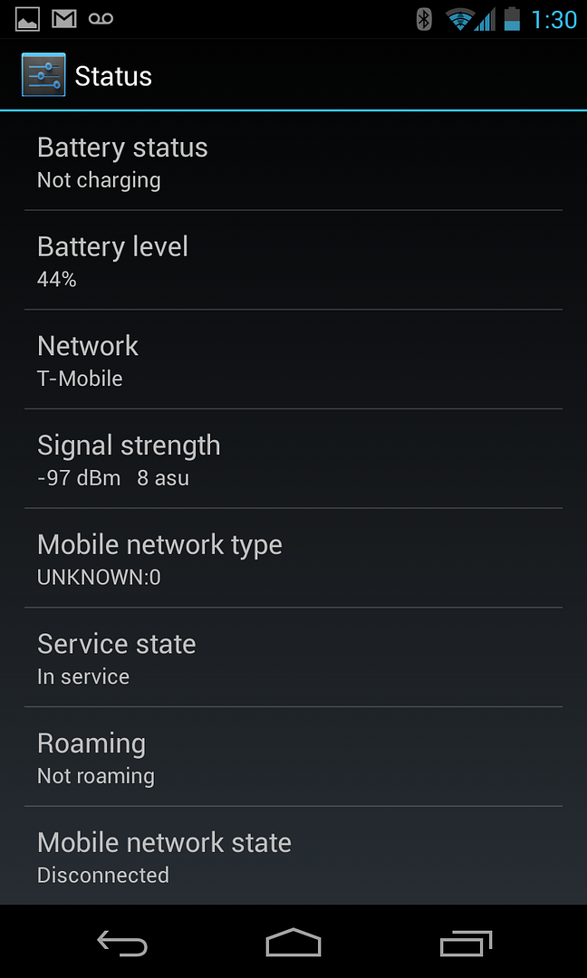

2. I am getting a triangle exclamation in the notification bar:
"No Service selected network (T-Mobile) unavailable"
I tried two different ST sims... same result.

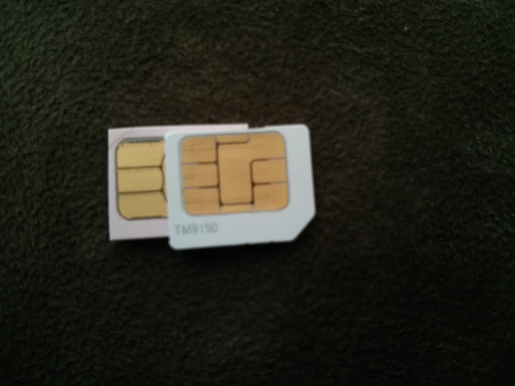

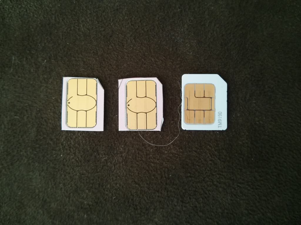

NOTE: I also have a T-Mobile Everyday 4g micro sim and the gold contacts are smaller than the ST ones...
Pink = ST
White = TMo Everyday 4g
When I insert the TMo sim everything works fine and I get 3-4 bars
so I don't think that it is my phone... and to be safe, I have a 2nd N4 that I tested it with and got the same results..

The phone isn't reading the SIM card, otherwise it would connect to a network. Not having an APN only means that data services (and MMS) would not function.
I think that you are correct... I guess that I ruined my sim cards.
Why are the gold contacts a different size I wonder... (see pictures in first post)

Oh, by the way, your trimmed SIM card looks fine. I don't think there is a problem in that regard.
