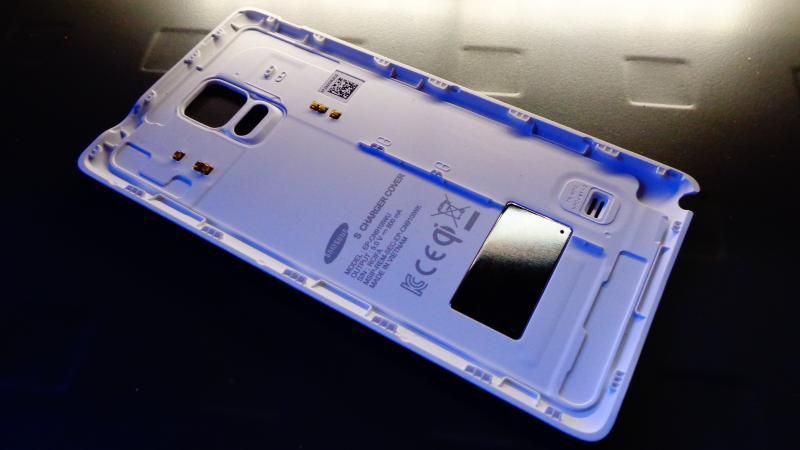

    Note 4 SM-N910A with charging back EP-CN910IBU and charging pad EP-PG900IBUSTA does not work.
    Charging back is PMA Certified and the charging pad is QI and WPC certified. All products are Samsung and not working so I'm thinking that the PMA and QI/WPC is not compatible despite the web saying they are all interchangeable and working.
    Any body have any thoughts or ideas as to why this is failing?

    Yeah you've bought two different standards. You either need to buy the Qi compatible back or buy a PMA charging pad. Sorry.

  3. tongrhj's Avatar
    Yeah, they're not interchangeable. Where did you read that?

  4. teshcnote's Avatar
    wow! why would samsung even make 2 different standard items? so frustrating! ok I'm going to buy a QI back to my note 4, thanks! I will report if it works.

  5. layout98's Avatar
    There's a pretty good big article about it here.
    https://www.andrewmunsell.com/blog/f...wireless-power
    Basically most of android has settled on Qi (meaning Google Nexus devices, LG, Motorola, and Sammy), but Samsung said it would support both standards beginning with the S4.
    To make things even more confusing AT&T has officially announced it would support PMA so if you buy a wireless charging back directly from AT&T it will be PMA but look EXACTLY the same as the Qi. So shop carefully.

  8. teshcnote's Avatar
    thanks all! got my QI case for my QI pad! cant believe there's another standard PMA though...SMH

  12. layout98's Avatar
    AT&T did not disable wireless charging. You can use either Qi OR PMA charging back on the Note 4.
    AT&T only sells the PMA back, so if you want Qi don't try and buy it from AT&T.
