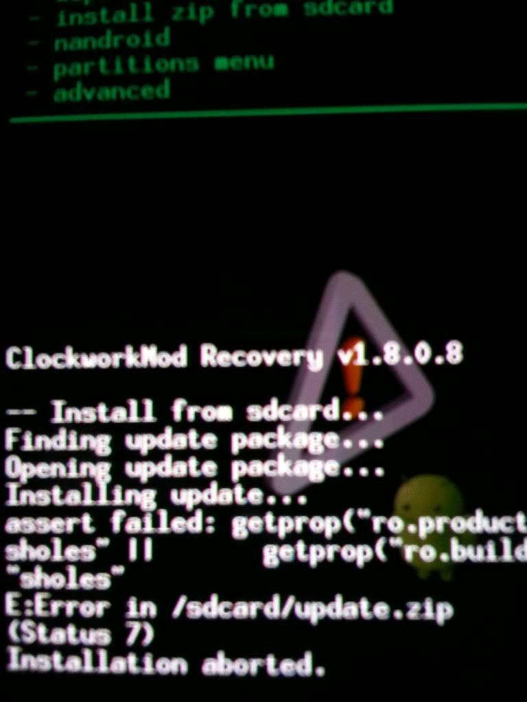

    I've been trying to update to Jrummy's remix and keep getting an error when attempting to install. I rooted and installed Cyanogen 5.0.6 Thursday night and was waiting for Jrummy to update. Anyone know what's going on? I am new to rooting and roms, so there is a possible I may have missed a step or two. I even attempted to use the rom manager which had me install clockworkmod recovery... not sure if that means anything or matters.
    device - n1 (at&t version)
    Thanks!

    That looks like there is an issue with the ROM that you downloaded. Clockwork was obviously installed properly, but the JRummy ROM contains some sort of error. I would suggest navigating your SD card, finding that JRummy update.zip, deleting it, and redownloading the file. Then try to do it again, and see if it works.
    Also, if you download it through ROM MAnager, it will ask you to reboot into recovery, and install it automatically, makes it much easier.

    Was I wrong in thinking that I needed to change the name of the name to "update"?

    I actually changed it to "Update" and transferred it to the SD card... after the issues, I realized the instructs said "update" (lowercase u) and changed it right on the SD card.

    Well. Since it is technically a new ROM, it would probably need to be installed via the Nandroid method, thats why it would be easiest to let ROM Manager do all that fun for you.
    I dont think that JRummy can be run as an update.zip from the Cyanogen ROM. Update.zip is usually just a small fix, a theme, or an update to a previous ROM, of like the same "family" in a sense. Like you would update.zip from the old Cyanogen ROM to this one, but not from Cyanogen to JRummy.
