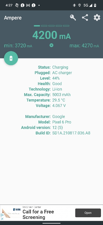

Here's the report... Starting at 26% battery, which caused the phone to charge faster in general.
Both the 20 watt and 30 watt chargers charge at the same rate, around 3700 mA
The PPS charger that I used with my Samsung charges much faster at around 4600 mA.
So, you guys are right about PPS (not that I doubted you, just wanted to report the findings.)
I'll have to return this Anker charger. I love how flat it is but it doesn't it has no speed advantage.

Here a comparison between my 24w RavPower PD car charger and the new 46w PPS charger I picked up
