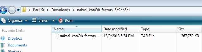

Okay you need to unzip that tgz file. Its just a different form of ZIP.
Once you unzip that file you will find the following...
Now you need to unzip that TAR file and you will get another folder full off files like below...

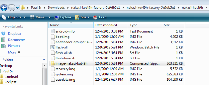

Finally unzip that remaining ZIP file's contents right to that existing folder and you should have something similar to what you see below when done...
Now best thing to do is take all these contents that you have unzipped and copy and paste them over to the same location/folder that you unzipped that r2superboot file package too..
Then with your device connected via USB and booted into your bootloader go into that file directory on your computer and select the " flash-all " file. Its the one with the little gear icon next to it also called a Windows Batch File. This will start the flashing process if all else with your connection is good.
Sit back and relax for a few minutes and watch the fun on your computer screen and also on your device. If all goes well which it should you will either end up back at your bootloader finished which you can then restart from there or they program may automatically reboot the device.
