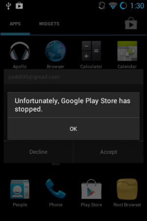

So I have this well used Optimus V laying around, it has been rooted for months now and been used for texts, calls, tethering, etc. until it decided to tell me it won't recieve mms. Regular texts, yes. Multimedia texts, no. Anyways, I recieved a brand spankin' new LG Optimus V from Virgin Mobile and am using that for my regular grind so I have this other one, plus a couple other spare Optimus S,V, T and One. I decided to look up ROMs that would be compatible with this Sprint baseboard phone, there are many ROMs and recoveries out there but I knew of two and decided Root w/ Gingerbreak, Backup and flash with Xionia CWMA and flash JB_gapps++ by Tantrums and BobZhome VM670 ROM with Jellybean.
What my problem is now that I have flashed this particular ROM with cyanogenMod10 is that I can't install and utilize Google Play and also that USB connections are very spotty at best on my Win7 laptop. I have reflashed Gapps twice, no results. The SD card reader must be malfunctioning because I have placed android app apks on the root of the card and the phone will not recognize them or install. I forced a download of the most previous version of Google Play and installed just fine but it will load up and then show me an error prompt that states "Unfortunately, Google Play Store has stopped." I've also noticed that in the notification bar that one app wants to download and install "Terminal Emulator" I believe but Google Play will not boot.

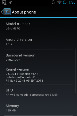

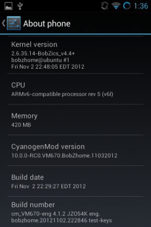

Attached are
screenshots
with available info. that might conclude a bug or fix, please respond if you have any ideas of a workaround to use Google play.:-$
