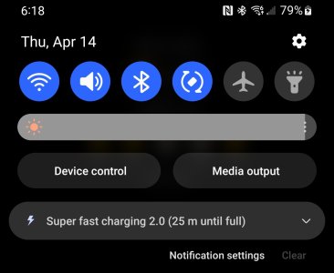

Ok looks like I was mistaken... So I just got in some of the official Samsung 5A cables (bricks are on backorder) and turns out the 65W charger I've had for a while actually works for Fast Charging 2.0.Screenshot_20220414-181831_One UI Home.jpg
So where I thought it was the brick that was the most important part looks like it is the cable 🤷*♂️

Ok looks like I was mistaken... So I just got in some of the official Samsung 5A cables (bricks are on backorder) and turns out the 65W charger I've had for a while actually works for Fast Charging 2.0.View attachment 344022
So where I thought it was the brick that was the most important part looks like it is the cable *

I thought you already knew that, lol. I even told you that I had a 65W charger from Samsung that came with my laptop and it wasn't registering the 2.0 at the end. Anyways, I ended up getting a 45W charger on Amazon and it works. I wanted to just get the cable but they were too expensive and many reviews of them burning out after 2 months use. Used the cable the new charger came with with my 65W charger and sure enough, it also registered 2.0.

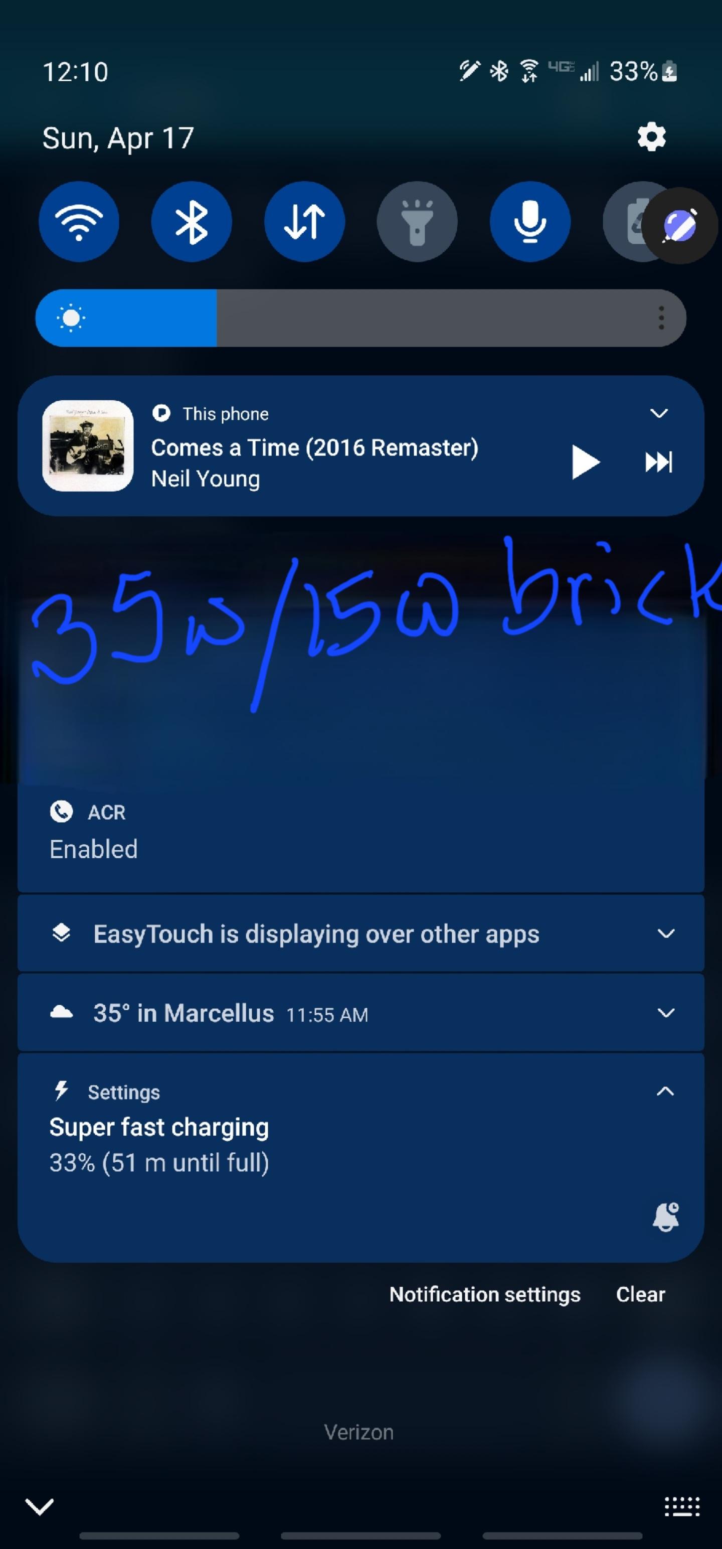

Help me out, here. I ordered the dual 35w/15w brick from Samsung. The actual specs on the brick say;
(USB-C PDO)
5.0v--3.0A,
9.0v--3.0A,
15.0v--2.33A,
20.0v--1.75A
(USB-C, PPS)
3.3-20v--1.75A
(USB-C & USB-A)
Max 20.w & Max 15.0w
My old Note 10 USB-C brick specs say;
(PDO)
5.0v--3.0A,
9.0v--2.77A
(PPS)
3.3-5.9v--3.0A
3.3-11.0v--2.25A
So am I correct in thinking that the max for the USB-C port is only 20w? Not 35w? Is volts & watts the same thing? In addition, the charging times for each brick is the same.
See the pics from Samsung website of what I ordered and see pics of charging times using a USB-C brick I received with my old Note 10 & the charging time with the 35w/15w brick, both using the same 1.8m, 5A cable.
