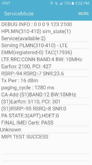

Take a screenshot of the screen shown while dialing *#0011# on both phones and post it here and I can tell you exactly what's going on.
Huh. That's odd. It should show something like this.

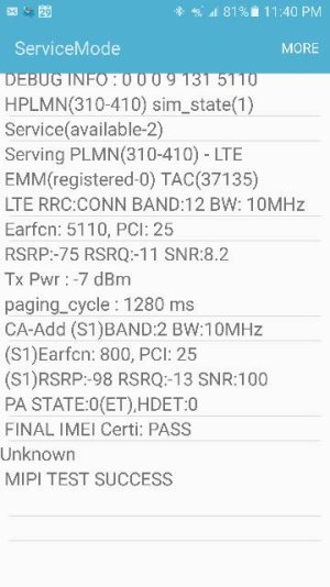

I finally figured out how to get the special diagnostic screen. Apparently you have to type the code instead of copy and paste it. 😑 Attached is the screen from my 930f. Do you need to see the 930a one?
- Chad

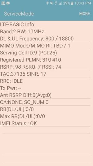

Also, if it helps, this is what I am running on my 930f. I definitely appreciate all the help from everyone.
- Chad

You're getting double the bandwidth, so double the speeds on the 930A. There's your answer. Look up the term "Carrier Aggregation" for more information.
AT&T Galaxy S7 Onyx Black with Unlimited Data
That's it. Carrier aggregation!
