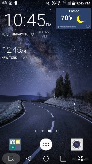

Along with my standard 3 buttons, I also have the quickmemo shortcut. It worked perfectly fine, and was great to use. After the Marshmallow update, the button doesn't work anymore. For some reason, it turns the flash on. Is anyone else experiencing this issue?

OP, I added the Capture home button and yes, it's turning on the flashlight. It doesn't do it if I click capture from the notifications pull down.
However, I am using Key-Plus to change the shortcut for the volume up button to turn on the flashlight, so that could be the culprit (if you're using Key-Plus too, like Darrell suggested).

I guess that would depend if you want to use the quick memo (now called capture) from the home buttons. Maybe instead just add it to the notifications pull down and use it from there?

I use the same app. It does change ALL the shortcuts. So on the LG G4 if you change the double tap up button which normally activated quick memo to turn on the flashlight. Then it (KeyPlus) changes all the shortcuts that open the memo app. It does it with other key changers also. I just got rid of the quick memo shortcut an used the regular app to keep the flashlight.

Except on the notifications pull down menu. The Capture+ opened just fine for me using that.
