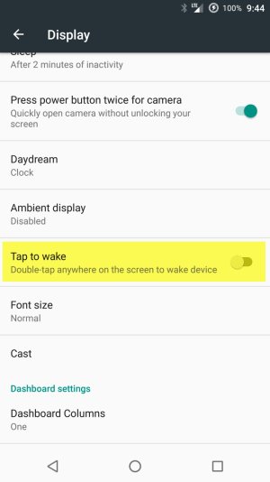

Thanks for the responses everyone, very helpful. I think I found the culprit. It was the "double tap" the screen to turn ON. I really don't need or want that option so I disabled it under DISPLAY SETTINGS. We'll see how the phone fares when I'm out and about today. If it still freaks out I'll give the Smart Lock settings a look. Thanks adam9997.

What Nexus do you have? My 6p has no option to "double tap" for the screen........
Do you mean the double power button press for the camera? That doesn't even unlock the phone, so not sure how that would get you into other apps, unless your phone isn't locked to begin with. I don't see any settings for "double tap" to turn on the screen, isn't that an LG feature?
I have the Angler/Verizon version of the 6p. The setting I was referring to is under DISPLAY.
I was wondering that as well, unless he has root and xposed I don't see how he has that option.
I do have root and have Xposed and XGel installed. Not sure if either of those drop the particular double tap setting into the DISPLAY menu or not.

I have completely stock on Project Fi and I don't have Tap to Wake. Must be from Xposed.
