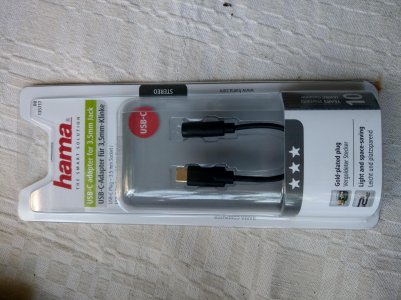

I do have another little issue too. I spent 15 pounds on a quality Hama usb c - 3.5 adaptor so i could also use my hi res Sony headphones only to realise i can't use my audio profiles, meaning the audio is worse than using my headphones on my 10 because i could use my audio profile!! Urhhhhhhh

Are you able to get good volume out of it too? i have to put it up to 100% and it still isnt loud enough
i also get a notification saying the phone is charging the connected device when i put it in the phone!!

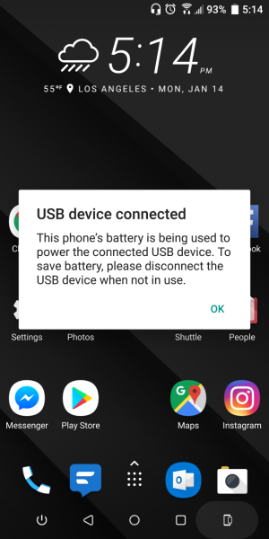

Oh yeah, it sounds incredible. It also has a built-in DAC, so you may want to check and see if yours does?
I attached a photo of what my phone says when I plug in the 3.5 adapter:

ok, ,mine has no DAC. I'm assuming this is the reason then?
I had no idea about these things having built in DACs before buying!

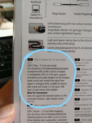

Thanks. Can you notice on my pic from the back of the package. It says 'converts the signal from digital to analogue'
That's not good surely?
Yeah, not sure about that. And that guy is a hater... it's 20 bucks well spent. I have two of them.
