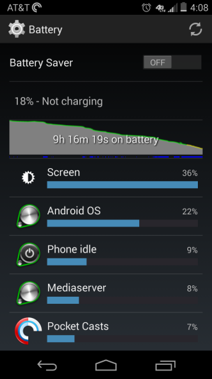

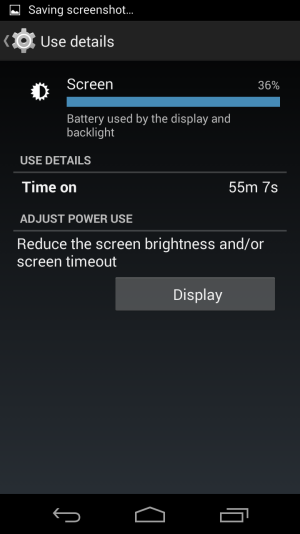

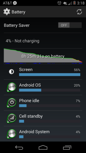

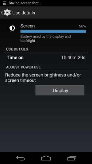

Ok, so I don't really know where to turn with this. I'm on my second Moto X (I RMAd the first one because of this exact same issue) and no matter what I do I can't get the battery life above 8-9 hours. My screen brightness is always set on auto, bluetooth is really never used, ditto for wifi, I am never anywhere with significantly reduced signal strength for any noteworthy length of time, and screen on time is never higher than about 1:30 when the phone finally give up (again, after a paltry 7-9 hours). I have tried more than one factory reset to no avail. Also of note i suppose, when left overnight for 6-7 hours I usually see 20-30% drainage which, like all else, seems insane.
I have attached screenshots from two days of use. One set comes a few days after a factory reset with no 3rd party apps installed other than Swiftkey (Newest version, i just can't live without it).The other set comes with a handful of the apps I use regularly installed again. Noteworthy is that apps or not, didn't make a whole ton of difference.
What interesting it that I went through this same song and dance with my first moto X, never finding anything useful to solve it and ultimately sending it back. I've been angrily and frustratedly putting up with it for the past several weeks and was galvanized to hit these forums again after hearing one of The Verge Mobile Show guys (Dieter I think) comment that he was getting 20-21 hour on his Moto X with 3-4 screen on hours. Generally such stories aren't inherently useful; because everyone's usage differs, but given his background etc. I can't imagine that A. He's a light user and B. its totally apocryphal. Given that, how am I getting less than half the battery life with less than half the screen usage?

What does the battery meter look like when you tap on the battery chart? Is it awake alot when your screen is off? If so, could be something causing a wakelock?
8-9 hrs definitely sounds odd. Your usage sounds similar to mine, and right now I'm staring at 7.5 hrs, half hr screen on time (but listening to podcast during a 15 minute commute), and 75% charge remaining, all LTE.
