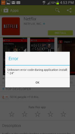

This is where I need some direction from everyone on here. On her phone she said it went to TWRP and a few things started scrolling, like when you flash something. After which she rebooted device and her external sd card seems to be erased, which is not a big deal as she had backed up contents on computer. When she goes to install an app from the play store she recieves the error -24 When I boot into recovery she still has TWRP which makes me think that the OTA did not take on her phone as it should be stock recovery right? I also accepted the OTA update on my SG3 and had the similar booting into TWRP and it seemed my phone didn't take the update as well, I am still rooted and running 4.1.2 (the one time i did accept an OTA it went to a screen with an android guy with an arrow or something to that effect, and in both our cases that did not happen)
I am going to try and factory reset her phone to see if that will make the play store error go away

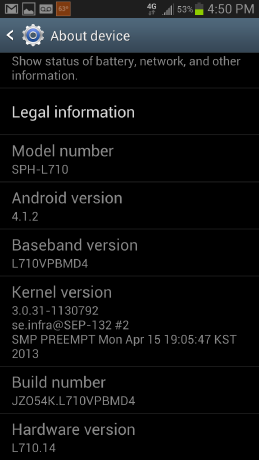

The update won't complete on a phone with a custom recovery, so it's not likely she has the MK3 ROM or bootloader. You can go into Settings / About device and check the build number, Baseband and Kernel to see.

this is her set up
That's weird. I can't see the image in your post, but can see it in my reply.
Anyway, your Android is 4.1.2, not 4.3, and baseband (modem) and build are MD4, which is the last version prior to MK3. And April 15 is the MD4 kernel. So it looks like you're good to go.
