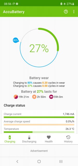

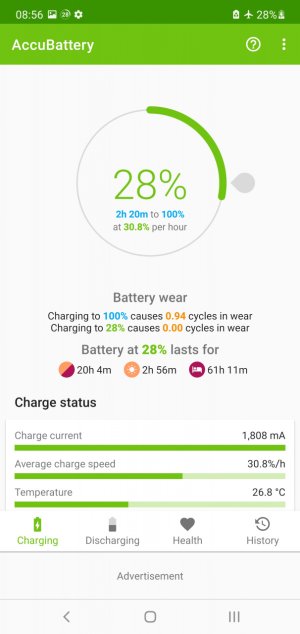

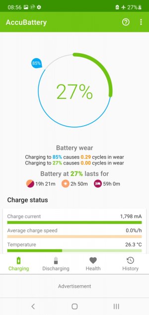

Hey friends.
So I got Note 10+ used with pretty bad battery I suppose,I'm geting only 5h 30min SOT which I suppose is bad.
So I want to preserve anyway I can this battery to last me as much as it can.
So I swtiched on power saving,switched on dark theme mode,turned off unnecessary services,and I even turned off fast charging option.
Don't understand this thing with Accubattery and "wear cycles".
App suggested me to charge to 80 % battery.
Judging by the pics does it mean that for health of my battery the best way is to charge it to only 80 %.
I will discharge it no more then 15 % cuz it's Li-Ion.
So please explain me and give proper advices.
Phone info under usage history is reporting me health og only 40.4 % (don't think it's true).
There is no charge count option in same app for some reason.
Li-ion batteries prefer a happy medium in terms of longevity. Charging above 80% and draining below ~30% will accelerate wear and decrease capacity quicker than doing partial charge and discharge cycles. People that routinely exchange their devices often times don't care about overall longevity and just charge to 100% and drain well below 30%. They don't keep the phones long enough to notice the added wear and tear, and sucks to be the next user of said phone. This is a article from one of the companies that actually test this sort of thing.
https://batteryuniversity.com/learn/article/how_to_prolong_lithium_based_batteries
That said, it is a balancing act for consumers between overall longevity and time between charges. That compromise is where the 30-80% and similar guidelines comes from.
As for your current battery, your SOT sounds about normal to me, but I can only speak in generalities because I don't have that phone. If that is a low SOT, then there isn't much more you can do short of replacing it. From my experience, once a battery starts going bad, not much will slow down the aging process. Internal resistance builds up, generating more heat, which means more heat related wear and less usable capacity, which means more charge cycles that wear it out more, and it's just a downward spiral.
