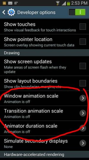

What about going into dev options and disabling all 3 transition animation settings to off?
I'm using a Verizon phone. I have a friend who has the same exact model and from Verizon, and hasn't had this problem on either of his two phones. Disabling animations doesn't work. I have a feeling this is related to action memo. I just don't know how to fix it or get samsung to fix it. And like I said before. I'd rather not root it or install any custom roms.
