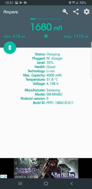

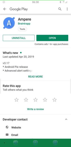

Download the Ampere app.
You will be able to guage the difference between chargers.
Remember, you won't get "fast charging" above 90% or so.
Wow that worked great. Interestingly the adaptive Fast Charge says 43 mins to charge and the regular is 49 minutesScreenshot_20190423-105127_Ampere.jpegScreenshot_20190423-105008_Ampere.jpeg
