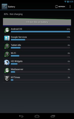

The battery life on my Nexus 7 is no where near this good. For example, I took it off the charger last night before going to bed. After 10 hours in "sleep" mode, the available battery had dropped from fully charged to 85% charged. Most of the battery drain is "Android OS", not any specific app. What can I do about this? Is there an OS setting I can change to significantly improve battery life? Do I have a defective battery? I can't quantify battery drain while the tablet is in use other than to say it drains even faster.
As batteries will cycle between 90-100% once hitting full charge, you might have just got unlucky and caught your battery when it was at 90% so then it really only lost 5% overnight.
Tap on Android OS in the battery usage and see if the Keep Awake time is very high. I had this problem, and deleting all the saved WiFi networks and rebooting solved it.

Wow! I didn't know Android devices shared saved WiFi network info. There were many in the list I've never used with my Nexus 7, so they must have come from my phone. I deleted most of them and rebooted, but that didn't help. I'm still loosing ~15% of the charge over a 10 hour period while the tablet is "sleeping". Right now, Android OS is showing CPU total 43m 32s and Keep awake 2h 16m 52s. Is it possible one the apps I have installed is triggering the excessive "keep awake" activity?

I tried changing a few settings. In the end the one that worked was changing the "Keep Wi-Fi on during sleep" setting to "Only when plugged in". Previously it was set to "Always". I was confused by the battery usage chart since it didn't show Wi-Fi as my worst battery hog. But I guess it's what the Android OS was doing because Wi-Fi was on that was causing my battery drain. Once I changed the setting I started seeing the normal ~3% battery drain overnight instead of the ~15% I was seeing before.
