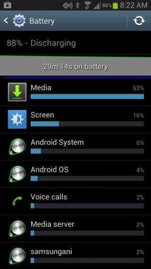

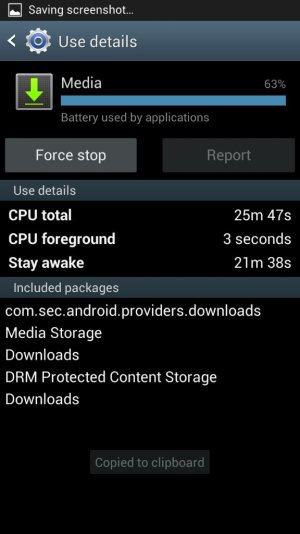

I started having issues with my phone the other day. Battery life was getting killed. The Media process is running constantly, not allowing the phone to sleep. Finally last night I did a full reset and set everything back up. The problem persisted, so I started deleting apps. I even disabled media. No matter what i did, media kept running, even after disabling it, it would start nack up. I reset again this morming as a new device. I did not install any apps, yet the problem is still there. I think there must be a hardware issue.
Does anyone else have experience with this?
