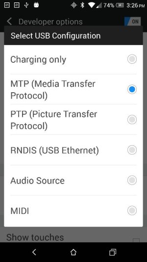

Re: After the marshmallow update my M9 sd card is not mounting on my mac osx el capitan
Looks like that isn't an option anymore... I can use Android File Transfer on my Mac or just use my PC laptops...
