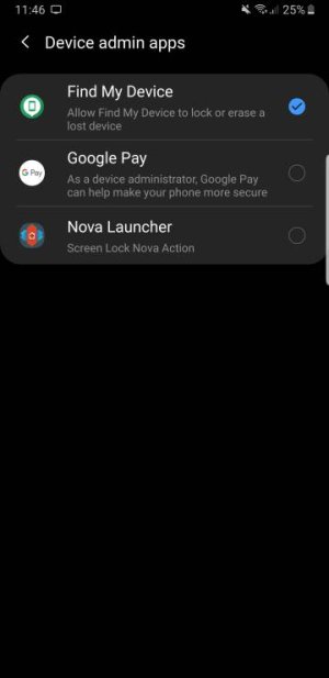

Can you go to biometrics/Security>other security setting>device administrator ...tell me what you see there ? Or screenshot of it
Thanks for the responses. I do not see a way to post pics. Also, i do not know how to boot to safe mode on an unrooted phone. I would rather not get that deep into the rabbit hole unless i have to.
Here's how to post a screenshot: http://forums.androidcentral.com/ge...ide-how-post-screenshots-android-central.html. If you're using the main Android Central app, I think it may not let you attach an image in a reply for some reason, so try using the web interface instead.
Safe Mode is a very basic troubleshooting step, and won't cause any problems -- a simple reboot from Safe Mode will get you back into normal mode. The link in my previous post gives steps on how to boot into Safe Mode.
