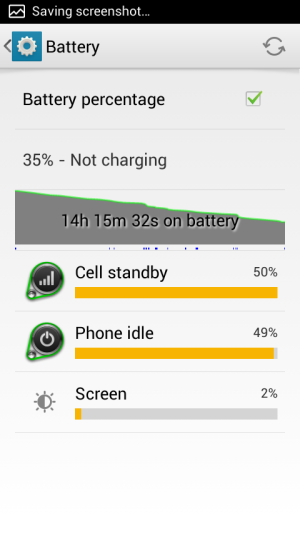

Hello i need some help with my phone, something is drainig the battery very fast, so i am charging my phone every day it may happen to do it twice a day if i do some calls or send SMS, i dont know what to do and when i put the charger on the battey is getting full in about 1hr. and then draining so fast. i am using this device about 6-months.

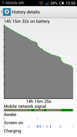

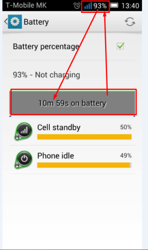

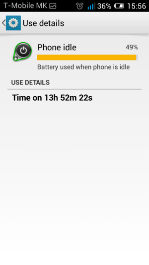

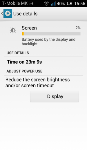

Charge up to 100%, then let it drain to 20-30% with normal usage, without charging in between. Then show us:
1. The main Settings>Battery screen.
2. The fullscreen battery graph screen (which shows Awake time and Cell Signal Strength).
3. The Screen category (to see total Screen On time).

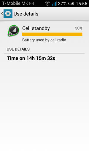

4. The Cell Standby category, if present (to see Time Without Signal).
How old is the phone? The battery could be failing, or defective. I'm not sure how easy it is to replace it yourself, considering it's not easily user-removable.
Try also booting into Safe Mode, which prevents all 3rd party apps from opening. This can tell you if the battery drain is being caused by an app you installed. On most Android devices, while powered on, press and hold Power until you get the power menu. Then press and hold Power Off until you see the Safe Mode prompt. Tap OK.

Read post #2 in this thread, then show us the requested screenshots. Let's see if there's something different going on with your phone.

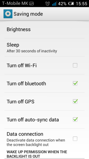

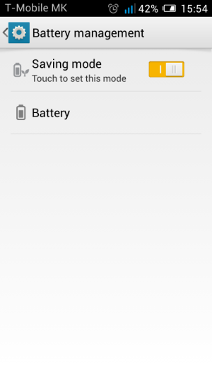

look there is something happened i did the Safe Mode solution again and my battery became a little bit better than before and i know that Safe Mode prevents all 3rd party apps and this made my batter a little bit better so i want to know what are the apps that use my battery which prevented to open in Safe Mode?
I'll post screenshots
