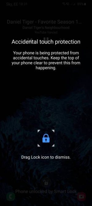

The Proximity Sensor is clearly still working when the phone is in your pocket as you still have 'accidental touch prevention'. I gave it a quick test just covering the sensor then trying to touch the screen so I dunno why they removed the Always On Display turning off also when in a pocket.
