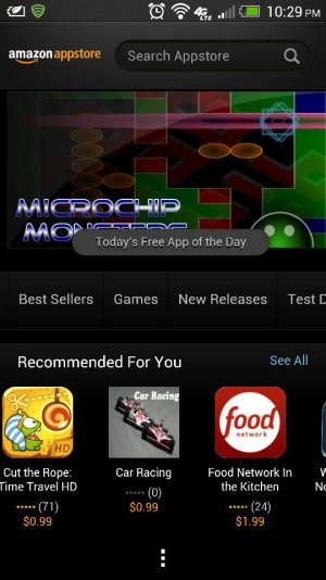

I don't have the HTC One but I am following the threads as I might possibly be purchasing one. Anyway, on my Galaxy S3 I just opened the Amazon App Store and received a notification there was an update. There was no change log so I am not sure if it fixes the issue for the One and other high resolution phones or not but I wanted to let you all know an update was just released. Maybe someone can give it a try and see if it fixes the issue now. Of course it might be good to have an old .apk just in case it does not.
I can confirm that the app now works on the One. Thanks for the heads up!
