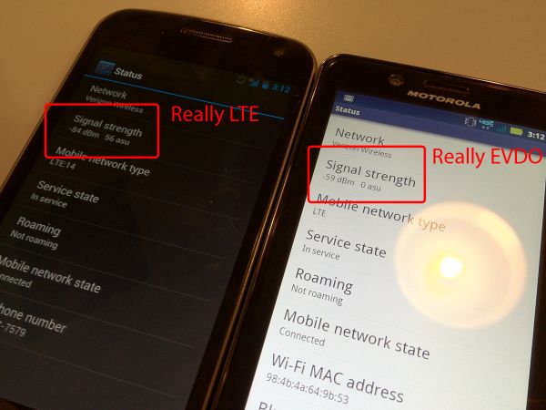

Read this excerpt from Brian's article:
The issue here is that on basically all of the LTE/CDMA Verizon handsets, the field under ?Signal Strength? in about refers to EVDO signal strength, and not LTE signal strength.
In other words, when the Thunderbolt is in LTE mode, it's STILL displaying it's 3G connection. Notice that the Galaxy Nexus' 3G connection is the exact same as your Thunderbolt's "LTE" signal? Yes, your Thunderbolt goes down to -82 in 3G mode, but that's not a very high variance. It's possible if you tested it 30 seconds later it would have been at -90 again.
Everybody in every one of these signal threads needs to read the full article. In it, you can see that Brian actually has to run a logcat to get true LTE signal strength readings on the Bionic because it only displays 3G signal strength under "About Phone." For the Charge, he has to hack into a special menu in order to reveal it.
Click to view quoted image

As a matter of fact, for Thunderbolt, there is an app called "LTE On/Off" which shows pretty much all the info of LTE/EVDO/1xRTT signal strength. I used it for my Thunderbolt.
Not quite. To this day, there is no way to accurately get the LTE signal strength on the Thunderbolt. Select other LTE devices had a special/hidden menu in which you could access this value separate from 1xRTT signal (that picture of the Revolution's menu comes to mind), but the Thunderbolt (to the best of the community's knowledge) has no such feature/ability.
