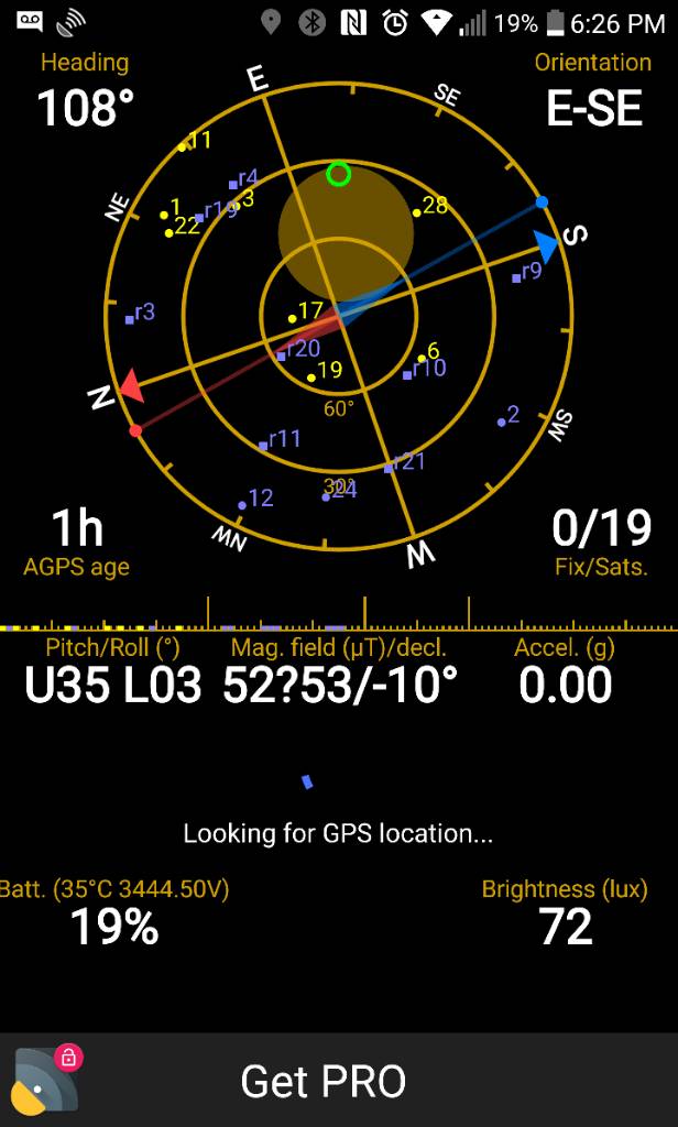

Hey I tried that app and i think my gps sensor is messed up. I took a screen shot and it always says looking for a gps location and never finds one.

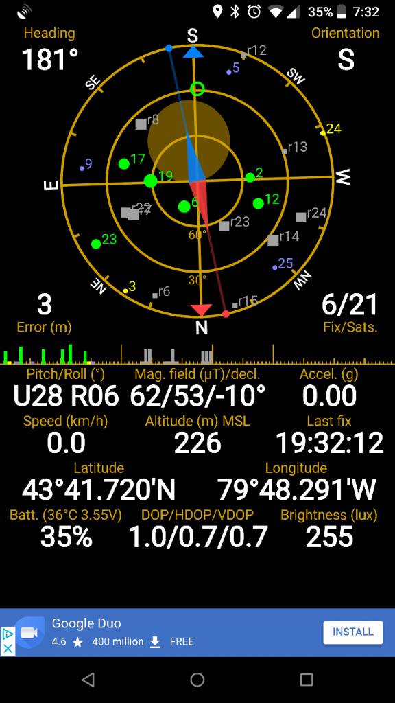

So I have a new phone and I used the app above and it takes about 2 seconds and it located my signal as seen below. I'm going to reformat my LG g5 and see if that fixes the issue.
Thanks for your help.
