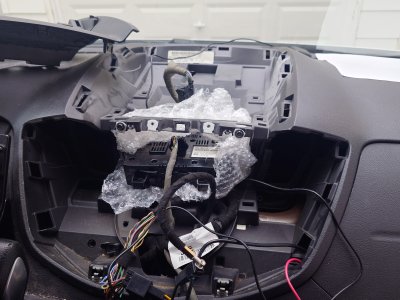

We planned to let it auto start always, but the problem is when we are home. Because of how I had to wire the radio, it powers up any time the accessories do and not simply by the key position. I.e. When using the key fob to unlock it. The accessory circuits stay powered on for 30 minutes after shutting the car off or since the last trigger that activated them.

And yes CAN BUS is basically a controller set up, but it controls virtually everything these days. There are very few devices that are triggered by a simple switch anymore, which is the problem. Heck, I had to pull the key pad from the original radio face (the body and display were two other separate pieces) and stuff it up inside the dash to keep one factory plug connected so the airbag light wouldn't trip. Yes, the airbag is tied into the factory radio. This is what is currently sitting behind the new radio. I don't like Android radios that are basically a glorified tablet, but at least it left me enough space for this cludge.

Well I got it dealt with. I ended up getting a CAN bus decoder for the radio, which now lets it properly turn on and off based on key position (I hate computerized systems). At least now I don't have to worry about the radio kicking on just because we unlocked the doors or staying on long after we have parked and gone inside. It doesn't address the question of Android Auto hijacking the phone, which I still can't fathom why they made it so pervasive, but at least stops it from happening while we are home and not using the vehicle.

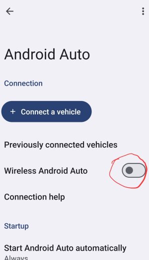

You can turn off wireless android auto in the settings (Settings -> Apps -> Android Auto then scroll down and select/tap "Configure in Android Auto". One of the top options is a toggle for wireless AA. I keep mine off all the time because I prefer wired and we have the same race condition in our house if more than one of us gets into the car. I am pretty sure you can map with Macrodroid or Tasker to make it a toggle on your home screen if you frequently want to turn it on or off.
You can also get there from Settings->Connected Devices and scroll down to Android Auto and tap it. Just not sure if it is the same on non-Samsung phones.

It is possible that you have to enable developer options in Android Auto to get the setting. But, I thought all the "developer only" options were in a special submenu.
I think I've seen the setting there in the past. However, it's not there now. As far as I'm aware, I have developer options enabled.
