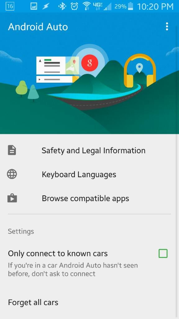

This is what my screen of the app looks like:

I don't remember it now, but there were a series of prompts on my phone when I first opened the android auto app and it wasn't paired to a car. I think it was just safety messages and such that you just had to hit "next" to.
That's what my screen looks like as well (with safety info and keyboard settings).
I'm thinking you didn't finish setting it up somehow and it won't let you try and set it up while driving.
