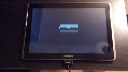

Right now the only thing it will do is hang on the battery charge animation if it is plugged into the wall charger (correct charger also).
If I plug it into my laptop it sounds like the USB is trying to connect and failing.

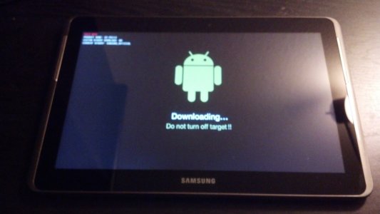

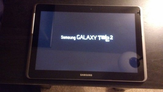

I can unplug it from everything and get the first white Samsung Galaxy Tab 2 logo (the one before the animated Samsung logo).
But it will just hang there unless I press the buttons to go to the custom OS install screen (the only one I can get to at the moment).
Looking at this now : Install Original Factory Rom on Samsung Galaxy Tab 2 10.1 P5xxx - YouTube
From that screen have you done a wipe data/factory reset? Try that and then reboot the tablet.

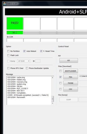

I did earlier this year when I could actually GET to that screen. No such luck this time. I am following the instructions of the video right now so I will try to get to that screen when it finishes. The problem is that when I tried this a couple days ago it said that it completed successfully but then would still not boot correctly. Keeping my fingers crossed this time.
Well it looks like it 'succeeded':
BUT still get this during wall charging and no booting:
Not sure what the problem is.
