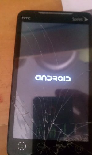

I bought a bunch of evos off ebay as a lot. I intended uses them for parts and fixing them. I consider myself pretty skilled at fixing the evos as far as hardware parts are concerned..software..not so much. One of the phones i bought stays stuck on the android screen and just flashes..i assume it has been flashed at one point. Can i get any help on fixing this problem? Im more or less a beginner in the software part of the phone, so i hope you can keep the advice simple too. Thanks! here is a picture of the issue.

That would be a boot loop. And you would have to ruu back to stock. Look it up on the HTC evo 4g forum on xda they tell you how.

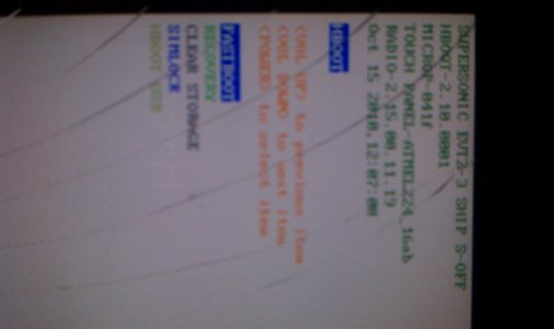

Is the bootloader s-on or s-off and what hboot does it have ?
power off, hold volume down and power buttons until it boots to the bootloader and look at the top it will have something like ship s-on or s-off. also let us know what hboot version it has.
use your vol. button to scroll through the menu, choose recovery and tap power and report back to as what it did, I would say if you have a custom recovery more than likely someone flashed rom rom and if its s-on the bootimg didnt flash which would cause it to bootloop.
Ok..i took pics of the issues you guys wanted..here it is. The first pic is the bootloader and second pic is what happens when i try recovery....then i selected reboot system now...same result. (android flashing)

You are s-off and that is a good thing. I would go HERE and download a rom, copy it to your sdcard, reboot into the recovery. wipe data/factory reset.wipe cache the go to install zip from sdcard choose the rom zip you copied there and flash it.
