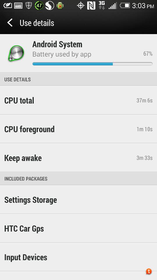

Android system draining battery. 80% of my battery is used within 4 hours of charging...can someone please help me fix it?

What's you total time on? Give us the battery stats screen shot that shows the battery graph.

Install Better Battery Stats and determine what's using the system time. The standard reports aren't granular enough.
