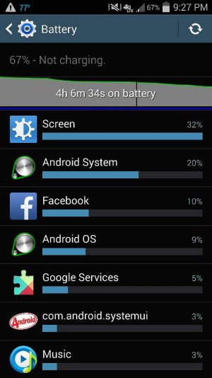

I turned on background restriction so we'll see.
I just completely turn off wifi and turn it on manually. It scans constantly now.

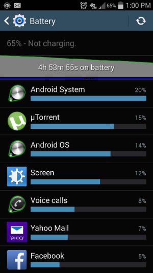

Tried cache wipe.even then android system takes 20 %
