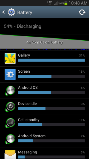

So I have had this phone for a couple weeks and find battery life awful.
The below screen capture is from being on charge over night, turning off gps, off with wifi, on with power save and having screen set to auto. The phone was removed from charger and not touched for about 4.5 hrs.
Is this normal? Signal strength is two bars and am on lte network with rogers in canada.
Cheers
Jeff

I would almost guess you have a somewhat of too weak of a signal. Phones spend a great deal of power staying connected to the phone signal they have, the stronger the signal, the less power it spends.
Although, in the screen shots, why was your Gallery accounting for 31% of your use? Just asking....

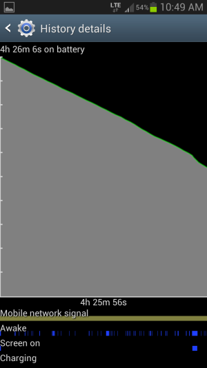

I thought the gallery use was higher than it should be as well but new to the phone so thought that might be normal.
You certainly don't have a great signal (that bar should be green), but the Gallery numbers are whacky - the Screen should be higher by far. Try rebooting the phone (to stop whatever is going on with the Gallery) and just let it continue to drain down to about 25%.
And screenshot the Gallery details just because.

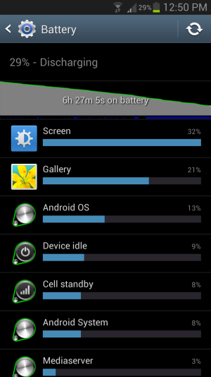

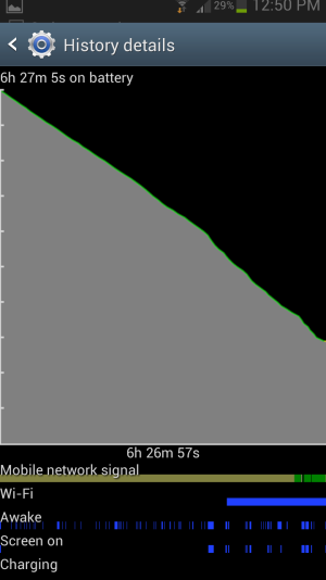

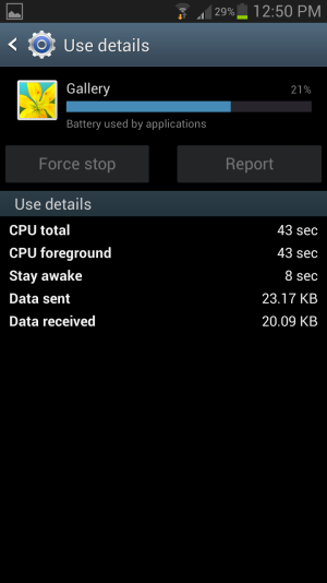

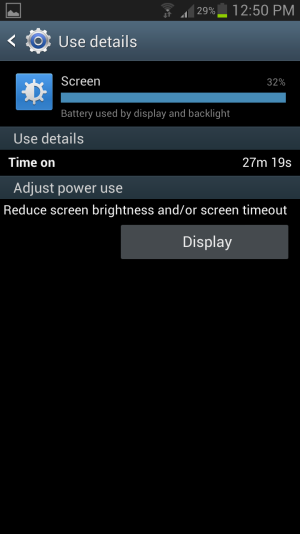

Had to run out so ended up using phone a little more. Went to the local Rogers store to see what they could offer for advice. Turned on wifi.
The one thing he did mention is to close running apps. He did this by holding home key and closing everything - I thought this just brought up recent apps to easy switch between them and not running. To see running apps I would have to go to task manager. What is the difference between the two? And what exactly happens when you clear the RAM?; if I clear RAM it closes many apps but if I don't do anything and just clear it again 5 seconds later it is closing many apps - I have assumed the apps that are closing are required by Android.
The other thing he did mention was to increase the amount of time between checks of email. I had no delay and he indicated this would require network access all the time. So now set to an hour off peak and 15 min on peak.
More screen shots attached.
Cheers
Jeff
Jeff,
Just forget what that person at the store told you about closing running apps - that's a bunch of hogwash. The only time you need to close a specific app (much less all of them) is if it's run out of control, which will usually be evident by a general slow down in the phone, or an app showing up at the top of the list in battery usage when you haven't been doing much of anything with it.
He is correct about the sync interval, though. You should check any apps that periodically access the Internet and make sure you're limiting their data access.
Your latest screenshots still reflect a sub-optimal connection, except the last part where it finally shows green.
Your phone was awake much too often, which probably accounts for its subpar performance - 6 1/2 hours, at 30%, isn't very good, particularly with only 30 minutes of screen on time.
Since you've changed the polling interval for email, give it a full charge and several hours of use and lets see if anything changes. You can also try:
BetterBatteryStats: http://market.android.com/details?id=com.asksven.betterbatterystats
GSam Battery Monitor Pro: http://market.android.com/details?id=com.gsamlabs.bbm.pro
SystemPanel: http://market.android.com/details?id=nextapp.systempanel.r1
Wakelock Detector: http://market.android.com/details?id=com.uzumapps.wakelockdetector
to see if any of them help she'd any light on what's going on.
BTW, you can leave WiFi (and GPS, if you occasionally use it) turned on all the time without taking a noticeable hit in performance or battery life.
