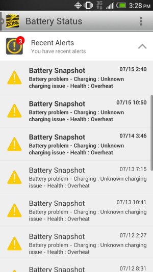

I was wondering if anyone has seen this before. When I go to sprint zone app, I check on battery and I get this> Is this an issue with the Sprint Zone app, or should I be concerned about the battery on my HTC ONE?

Are you using the normal HTC charging block? If not maybe that's why its overheating and causing the unknown issue. I've never had this problem
I see those alerts almost every time I charge my phone.
Sometimes at very weird hours like 1 am but the thing is I never keep my phone on charger over night.
Very weird thing indeed and something to worry if is real.
I started a discussion on the sprint forum, and I gave them the sprintzone app version. Other people are seeing this as well. There could be an issue with the sprintzone app, or something else...
