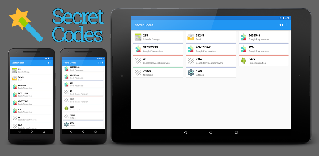

Secret Codes is an Open Source application that allows you to browse through hidden codes of your Android phone.
This application will scan through all available secret codes on your device.
Then you will be able to executes these secret codes a discover hidden functionalities.
