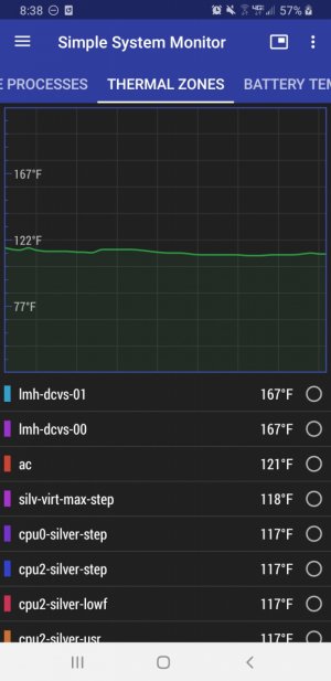

I upgraded Android from 9 to 10 on my Note 9 last night and ever since then, my phone has been getting really hot and overheating. It's interrupting the charging cycles on my battery and it's charging extremely slowly. I started charging it about 4 hours ago and its only at 57%.
I've turned off just about every app I can think of manually, I even tried turning off the wireless with airplane mode since most of the heat seems to be coming from around where the wireless chip is. I don't understand what's causing this! Please help! I need this phone for medical issues and I'm getting really stressed out from this. It's making my medical problems worse. I'm starting to panic and I don't know what to do. I have a tele doctor appointment coming up in a few days and my phone is running really really hot!
Today I left a charging and when I came back, the phone was off, It was really hot, the battery was dead, it wasn't charging, and wouldn't turn on. I had to unplug it and let it cool down before it would even start charging again. What's causing this! Why is this happening? How do I fix this! Please help!

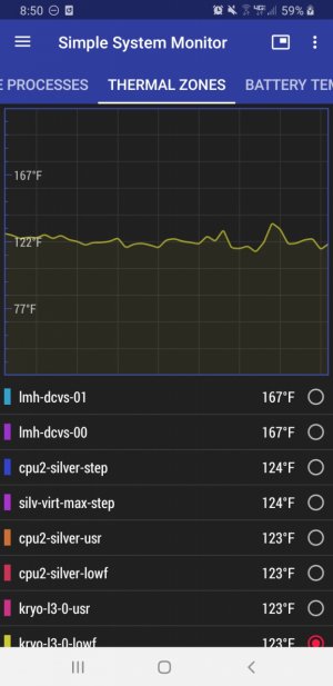

It's only at 59% and here's an update of the temperature readings

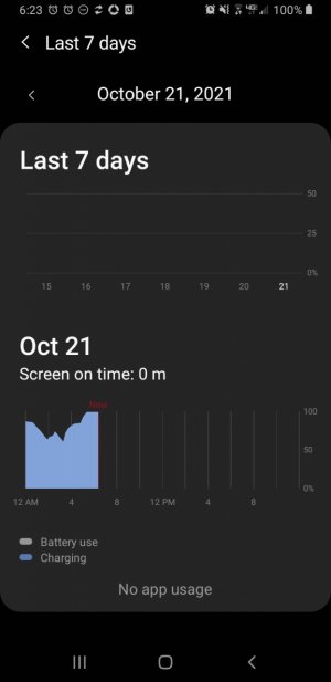

Im holding folded paper towels soaked in alcohol against the back of the phone to keep it cool so it can charge and back stuff up. And it's working! It's already up to nearly 40%.
I finally got it up to 100%! Keeping the phone cool with alcohol worked!
