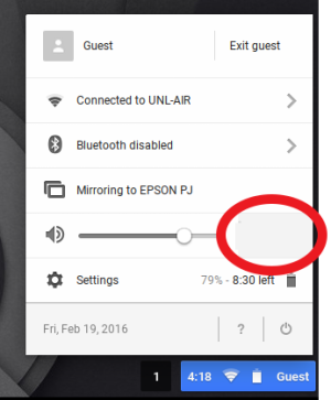

Recently my father lost audio from his ASUS Chromebit. The Chromebit has been connected to a TV via HDMI for several years functioning perfectly until a week ago when it lost sound. I have confirmed the TV is fine. All other inputs produce sound. What I found odd was when I tried to incrase the volume through the Chrome OS. See the pic for where I am speaking about. When I looked it showed the volume as ON (not muted), but volume set to 0. I grabbed the slider and increased volume. No change. When I reopened the panel volume showed 0 again. Even more oddly no device was shown as where audio output was going (empty red circle).
I tried a powerwash with no success. I did manage to get my Dad running again using a bluetooth speaker for now, but would like to find the problem.
