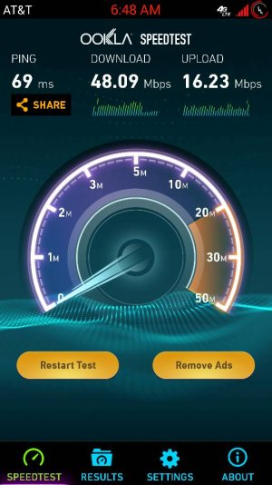

Lte should look like this
must have unlocked boot loaders!!
