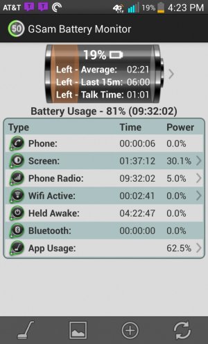

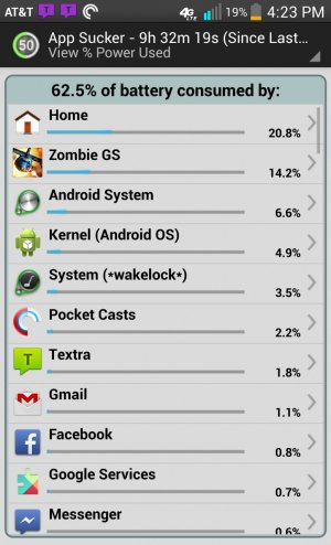

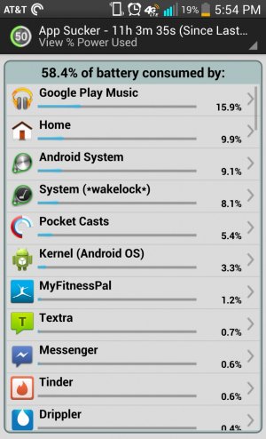

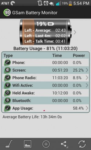

So I got ATT to send me a new device in the hopes that I had a defective one. I received said device the other day and after 3 days of typical use it's arguably WORSE on battery life than my original device that prompted me to start this thread. I have posted some battery life screen shots.
I'm not really sure what to do now. Some of you in this thread are experiencing the same thing, others appear to be getting the same awesome battery life that all the reviewers and many others are overjoyed about. Sooo, what's my next move? Rooting and flashing a custom ROM? Trying to root and get rid of carrier ID? If that is the problem, why isn't everyone with an att device getting hit? Ugh.
