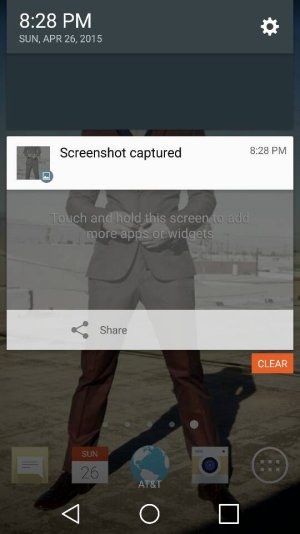

App notifications show up but when I pull them down, I don't have the edit or the other buttons. I just took a screenshot - 50152.jpg

Update: turns out I had no lock screen enabled and enabling swipe brought it back not the Vibrate on tap.
I tried changing the "Lock Screen Settings" from no-lock to swipe and it did not change anything for me. I have the same problem. When I swipe down, the notifications bar is completely blank so there is no edit button to choose. I was cleaning up some apps off my phone and perhaps deleted or disabled something I shouldn't have. Anyone have any thoughts on what? Or how to get it back?
Clear the cache then reboot. If that doesn't work then some files must be corrupted as there is no option to disable quick settings. You will have to do a factory reset. Whenever you update your phone you should do a factory reset. BACKUP ALL FILES to your PC before doing a factory reset.
Quick settings disappeared from seemingly no cause, about 2 weeks after I switched from no lock screen to swipe. I looked for notification / quick setting options in the system settings menu and it's nowhere to be found. (LG G2 Android 5.0 Update, T-mobile)
As dumb as this is (And I don't understand why it's related), This worked:
"Update: turns out I had no lock screen enabled and enabling swipe brought it back not the Vibrate on tap"
As soon as I did it and it worked, my thought was "that is so dumb...but I'm glad it worked":confused:
