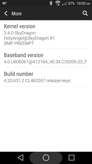

While I did not have real trouble with the International Dev firmware and modem, I did repackage the ATT 4.4.4 modem when updating to the Rogers 4.20 firmware. So, if you grab the ATT modem from the 4.4.4 update, and overwrite the modem in whatever firmware version you want to use, it will use the ATT modem without issue. Here is mine for example-
I replaced the modem in the Rogers firmware (from skydragon ROM thread on XDA) with the one from the ATT 4.4.4 update, and it has been working fine. You do need SOFF to flash firmware though, not sure what you can do without that.
