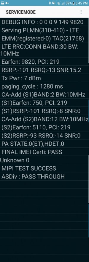

From what I am seeing my phone isn't using the 3CAA, is that correct since there are only two CAA listings?

You actually are using 3CA in that screenshot. I should have explained further.
That menu shows your main band which is download and upload - you'll see - LTE RRC Conn band 30 at 10x10
Then 2 more carriers / bands are aggregated to your main band 30 to add to your download
CA add s1 - band 2 with a bandwidth of 10 mghz
And then another carrier, your third, added -
CA add s2 - band 12 with a bandwidth of 10 mghz
You have a total of 30 mghz of download between the three, and since upload can't be aggregated at this time, you have 10 mghz of upload from your main carrier band 30
Granted the bands and positions will change, sometimes you'll get 3CA, sometimes 2CA, sometimes no aggregation
