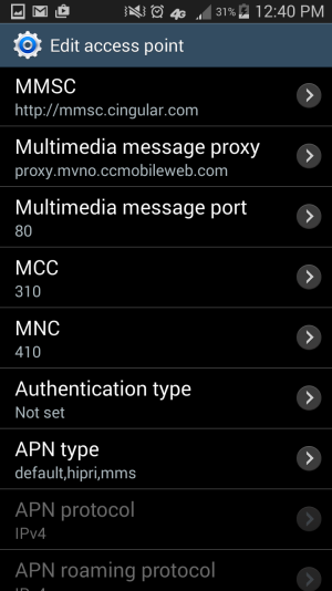

I got my friend's AT&T Samsung Galaxy S3 phone to work with Consumer Cellular.
I went to the website and the information was very vague and only works for 4g.
I had to search up and down to get both 4G and MMS (Multimedia msg and group chat) working.
Only one not in the picture is
APN: att.mvno
Good luck to those coming in the post late!
