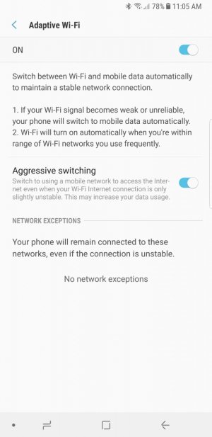

I have an unlocked note 8 SM-N950U1. My phone turns off automatically when I'm not home and turns it back on when I get home. I have aggressive switching turned on, I think that is all that is needed.
