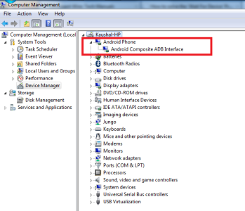

theres an issue with ur drivers. check them in device manager. turn ur phone on and plug it in pc. is ur device listed under "ADB Interface" or "Android Phone" in device manager? It will probably say "Android Composite ADB Interface" urs is probably different. mine says "Android Sooner Single ADB Interface" under "ADB Interface"

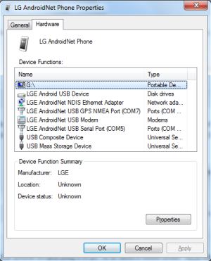

I get nothing in those categories. They don't even exist in devmgr. This is what I do get: Properties.png
U need to install LG drivers for ur phone. Here is a link http://www.lg.com/us/support-mobile/lg-VM701
scroll down and click on software update under "manuals & download" then go to step 1 where it says USB driver for windows. Click on download. Ignore step 2-4. Install a driver. When u r done, turn ur phone on and plug it in pc. if a driver is sucessfully installed, u will see a green check mark on icon in the system tray. Open cmd and type "adb devices" ur connected device should show up with a serial number
I tried this, and still got nothing... It still makes the device connect noise, but only the devices I showed before show up in the device manager.
