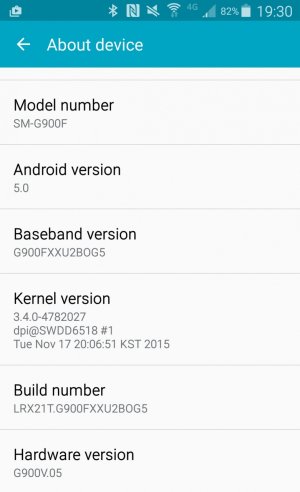

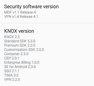

unfortunately it didn't work...
I did a factory reset of the phone, I formatted my SD card (after backing up my data)....there didn't seem to be any obvious way to format the internal storage, so I deleted everything I was able to.....after rebooting I still got the problem with the contacts app & the whizz home thing reapeared too.
I then tried a hard reset, rebooted, skipped setting up accounts etc until I got to the default home screen, tried to open Contacts....same problem, so it doesn't seem like I'm doing anything wrong, it's something to do with the device itself
I've also attached screenshots of the device details in case this helps at all
Any further suggestions?
Thanks!
btw, is this the right forum for this issue as we've moved away from rooting/flashing?

Right. In your shoes I would now do what a Samsung Service Point would do and that is to download the stock Samsung firmware for your model of phone and Product Code and flash it to your phone via Odin by carefully following the instructions and video contained in the links of #1.11 of 42 Galaxy S5 models - Dummies Guide. N.B. This is not rooting and does not invalidate any warranty.

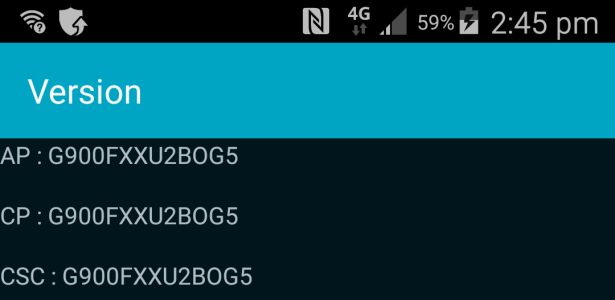

ok, so I've found where to do this & I'm assuming it's the first UK one as all the the other UK files seem to be for specific carriers/providers, none of which are Virgin, who I'm with.
A couple of questions about this:
1) does the PDA code given there (G900FXXS1CPGZ) have to match any of my phone's AP, CP, or CSC codes (see image below), or is it different because it's different firmware? btw, does knowing these codes change any of the advice you've already given me? Sorry if those are daft questions, but I try not to take too much for granted!
2) possibly another daft question, but could you clarify what you mean by Product Code?
3) will it matter which version of Odin I use? I'm guessing not, but on the download page for that firmware it says to use Odin 3.11.1 & in the "42 Galaxy S5 models...." it says 3.10.7

It is your phone's Product Code as detailed in post #6, above, that determines which firmware your phone is eligible for. As per the warning in the Dummies guide...
"Warning: This is for competent users and could void your warranty by flashing any firmware other than that intended for your original CSC and Product codes, see #1.8 above, as well as preventing future updates through Kies/Smart Switch or Over The Air, (OTA)."
How to obtain your Product Code is detailed in #1.8 of the Dummies Guide. The last 3 digits are the code.
